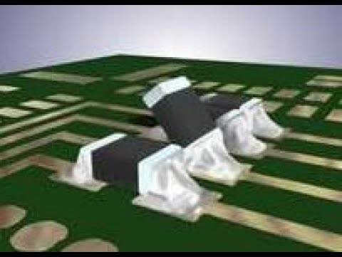

              Neat relevant video that popped up in my feed:
