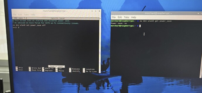

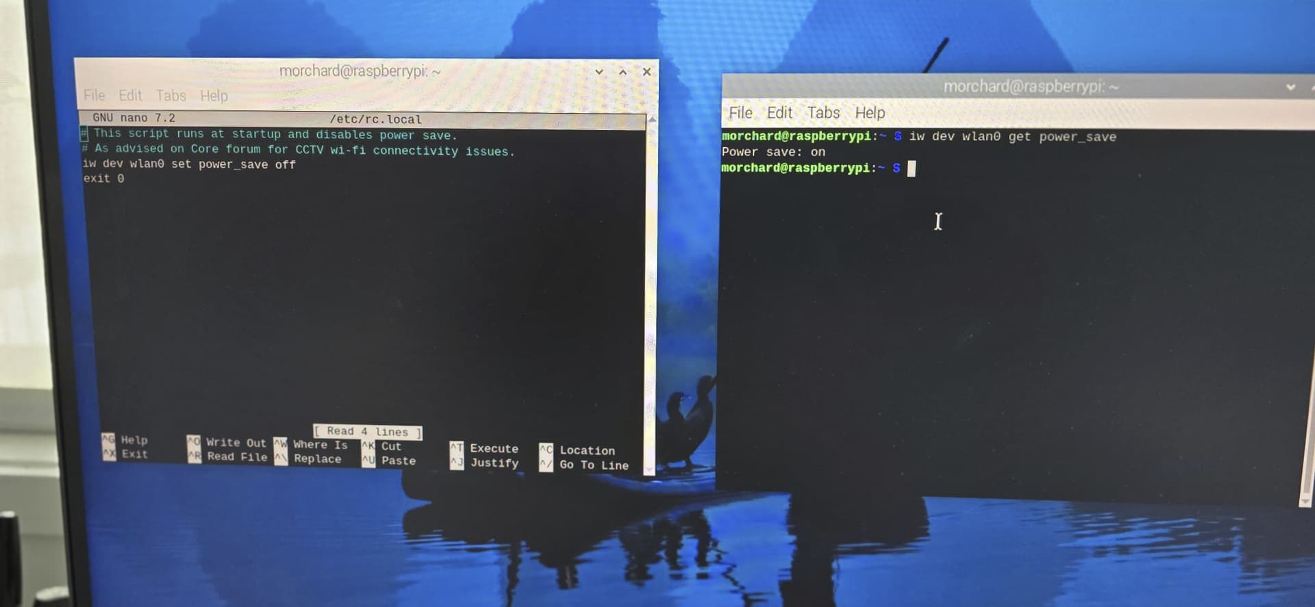

Thanks Ryan.
I did as you suggested but power save still seems to be enabled.
