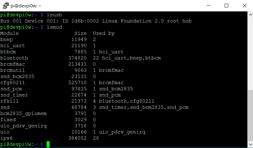

As for the tests you’ve followed, I’ve executed the lusb and lsmod commands on my own working PZW to the following effect. I’m not sure if there’s much information to be gained though, because I’m quite sure the on-board radios are handled by firmware, so they’re not USB devices. As you can see there is no radio listed by lusb.
I’ve posted the results anyway for anybody who cares to reference what a working unit looks like.
Note: I’m connecting via SSH so there are no USB devices plugged into the PZW.
