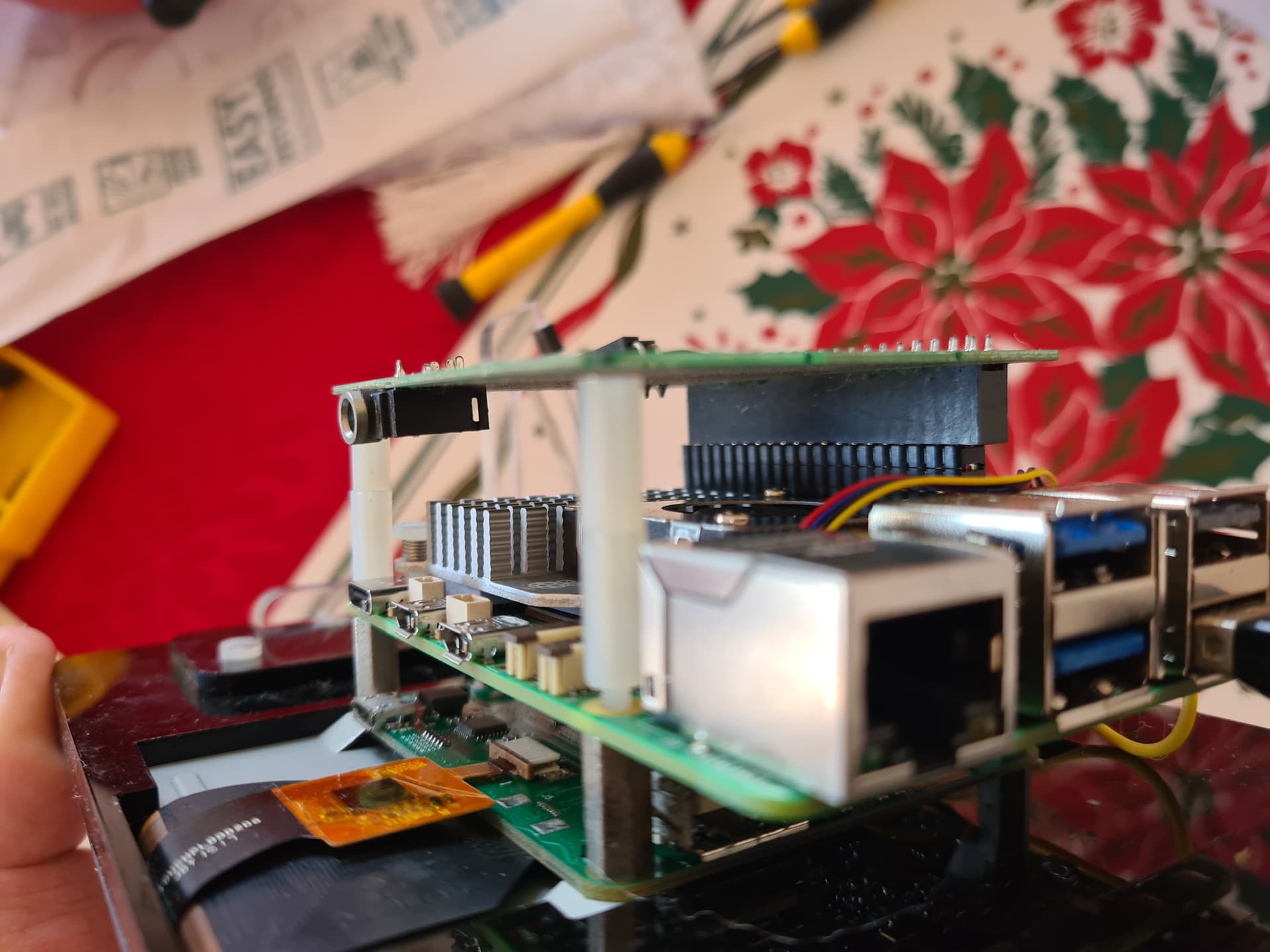

Upgrading an old PI3 setup that has a PI3 with HIFIBerry DAC+ and V1.1 screen to a PI5. As of this moment I only have the PI4 power supply and was wondering if anybody has a similar setup. I replaced the PI3 with the PI5 and added a header extender then doubled up the DAC standoffs to lift the dac away from the PI5 heat sink. Unfortunately I didn’t do my homework and don’t have the DSI FPC cable for the screen (ordered from Core but don’t have yet) so can’t test it. With the PI3 I could run the supply to either the PI3 board or the screen board to power the setup with no issues.

If that’s the case then on to question 2. The screen board has its own power connector so if i was to plug the PI3 supply into that and plug the PI4 supply into the PI5 board will that work? Currently the screen gets its power from the PI through the power leads from the DAC (see pic 1 above). If I unplug them then that should work…maybe. The only connection then from the screen board to the PI would be the ribbon cable and I don’t know if that supplies power as well as video.
