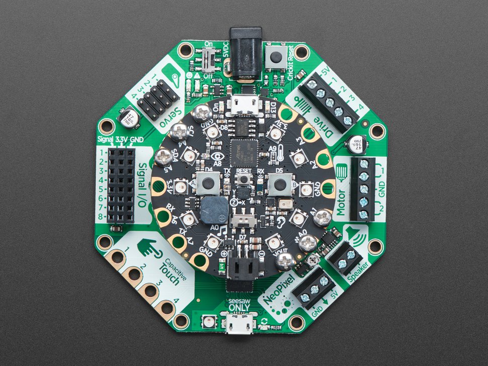

You can control a DC motor with the circuit playground express. A small hobby motor can probably be driven directly off the board (though I wouldn’t recommend it).
A motor typically demands more current than a micro controller can supply directly. So a Motor Controller must be used. The micro controller (in this case Circuit Playground Express) sends a digital signal to the Motor Controller, and that handles the high current to the motor.
Adafruit has a great breakout board for the Circuit Playground express that turns it into a full robotics platform. It has motor controllers, servo connections, solenoid drivers, easy connections for an external speaker and NeoPixles. The Circuit Playground Express just screws onto it.
Probably the best part about it is that it has full MakeCode support, as well as CircuitPython support, so programming with it is easy!
