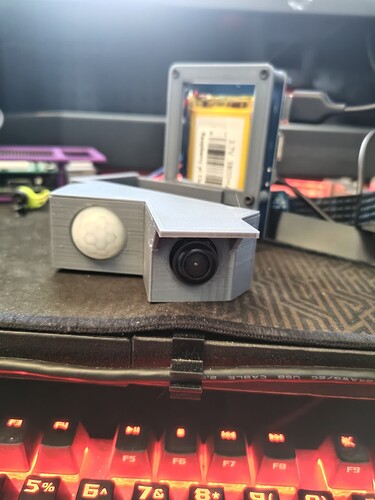

Made a hella simple PIR triggered camera with a pi0 after our dinnerly was taken on Monday. Using a fisheye unofficial cheap pi cam & PIR sensor from the local jaycar. Hoping to have it deployed Sunday night for the next one.

Hi, thanks for sharing your project. Can’t see the clear picture of your camera. Earlier, from this article I came to know that there are a couple of camera PCBs to choose from. Which one did you choose for this project? Is it The Raspberry Pi Camera Module v2?
No I used an Amazon cheap one in case it gets smashed. You could use any though, I use the official ones on my octoprint & octoklipper setups to monitor 3d printers.

Of course! Although his are staged, mine are not. I did get pics of the delivery guy though, and no stolen Dinnerly. Needs more tweaks though, .
Frustrating to power portable pis though, I ended up throwing an anker powerbank at it last night, which has more storage and current than all of the pi specific powerpacks and converters. Hanging out for a company to make something better than the Adafruit powerboost 1000c (or this dodgy one I got from jaycar which can’t charge and power at the same time).

Looks the same from a quick search, walked to Jaycar to get one to make sure I could build it in time to deploy for the next delivery, theirs is xc4444.
Used it twice now, have pics of it being delivered and haven’t lost one yet.
Still would like to improve it to run the program from a physical switch, and automatically transfer the files.
