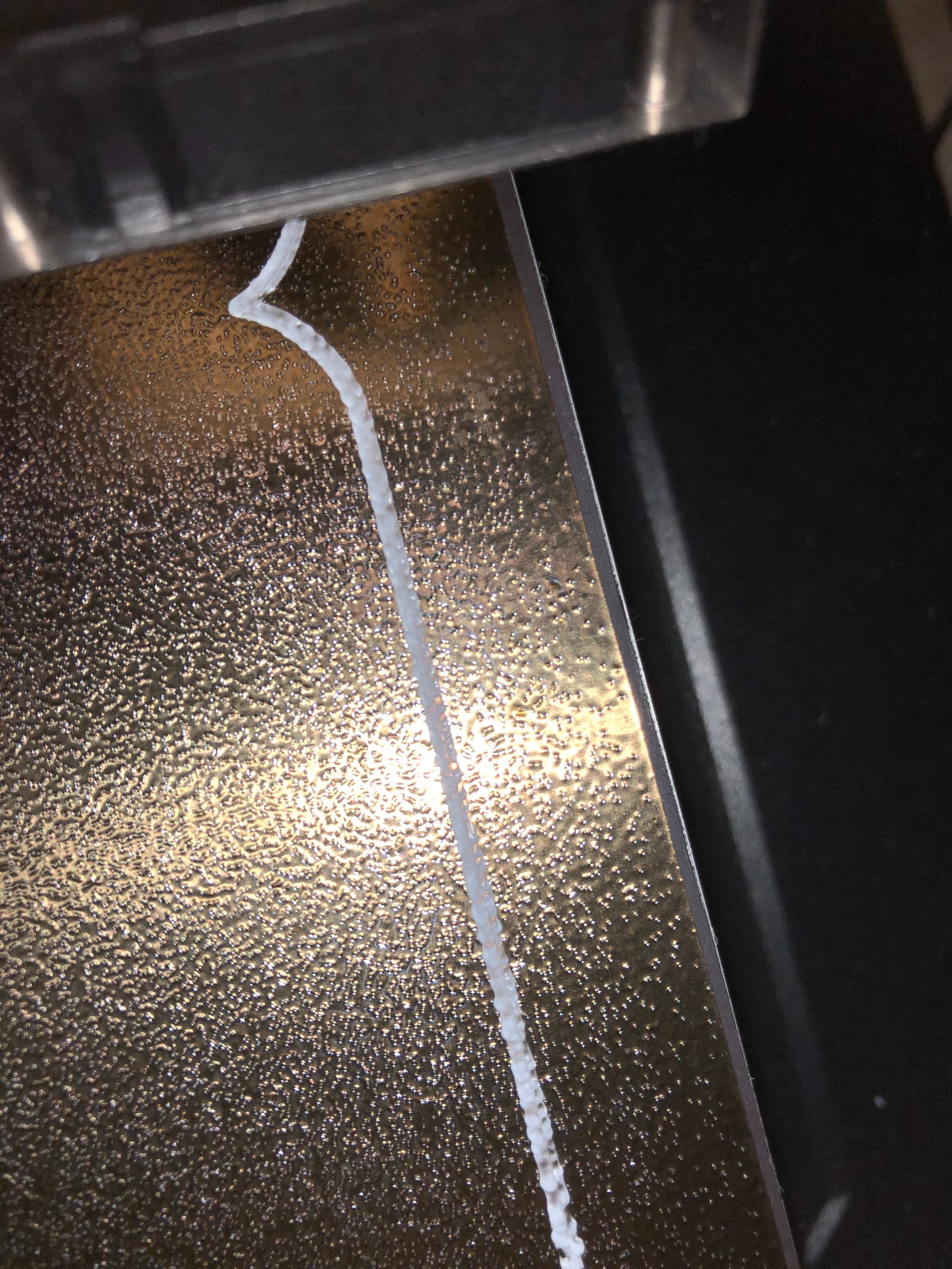

My PEI sheet is definately a gold colour, see attached photos. Its also a dapled / rough surface, not smooth.
I have currently got 4 boxes on the printer printing - I put a brim on them to help the corners stick and that worked for printing 1 box in the middle of the bed.
When printing 4, its a tight squeeze so uses all the available bed. 1 corner has started to lift. I have up’d the bed temp to 85^C (it was set at 80-^C) and placed a little UHU glue stick under the lifted corner to stick it back down - I’ll see what happens.
I have also attached a few photos of the first layer.
Looking closely at the pictures, Im wondering if I need to lift the front right corner of the bed slightly. If thats the case I am somewhat perplexed as to why the auto-leveller isnt compensating for this small difference in level???
Interested to hear what you guys think?
Thx
J
Hi Jon,
For some reason, I really can’t tell whether that corner is too low, or too high! I’m used to a smooth surface where a “beady” extrusion mean’s your head is too high, but in this case, maybe it’s a bit too low, and the filament is building up pressure in the nozzle and spurting out in the “valleys” of the textured surface.
How does the standard paper test come out in that corner? (move the head over there, how easily can you slide printer paper or a sticky note underneath it.
Ok guys, update time.
I went back to basics again and re-levelled the bed, manually with a piece of paper. It was a little out, but not a lot and certainly should have been within the tolerences of the auto bed levelling mesh. Either way, its as spot on as I can get it now.
Interestingly enough, once Id levelled the bed manually and then run the auto bed levelling routine, the first layer didnt get anywhere near close enough to the bed… I had to manually adjust the Z axis by maybe -0.5mm, maybe a bit more!
Once Id printed a few single layers around the edge of the bed (tweaking the Z axis as I went), I was happy the bed was level and the Z axis looked right. I think it was too low before.
The only unknown now was the bed temp. I went out and bought an infra-red temp sensor thingy and started measuring… When the software is set to 85^C, the centre of the bed hits around 78^C, but interestingly enough, the bed temp seems to proportionally fall away with distance from the bed. To the extent that the edges of the bed are maybe only at 72 - 74^C.
Back to my boxes that I needed to print - 4 boxes fill the whole bed, with just enough room for a brim around the edge.
49 hours of printing later and I now have the best 4 boxes Ive printed.
I still have questions though.
I did read that my GCode should contain “M420 S1 Z10” right below the G28 Home line to instruct the printer to use the mesh from the bed levelling routine - It appears that this raises the nozzle height too high and then requires me to bring it back down again, otherwise the PLA doesnt get anywhere close to sticking to the bed. Just wondering if you guys use this, or whether I should take it back out again?
More test printing to do I think to see if the bed re-levelling or Z height ajustment was the key, or maybe both!?!?
