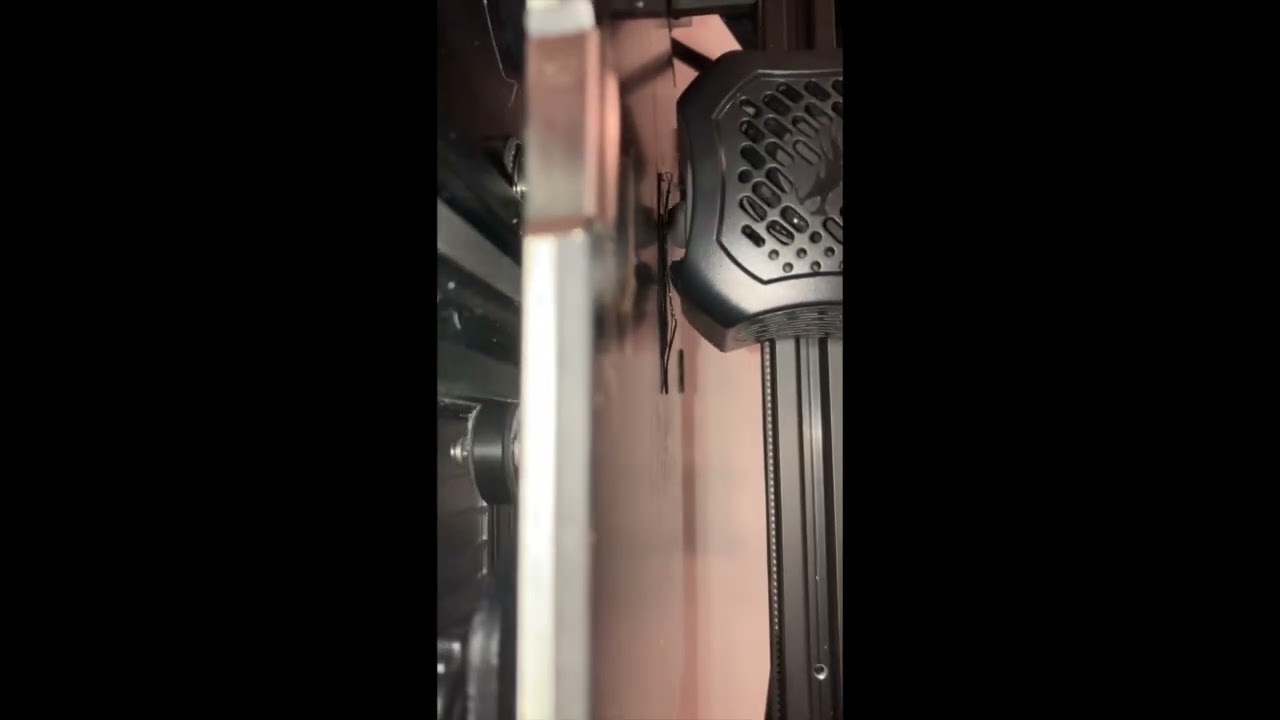

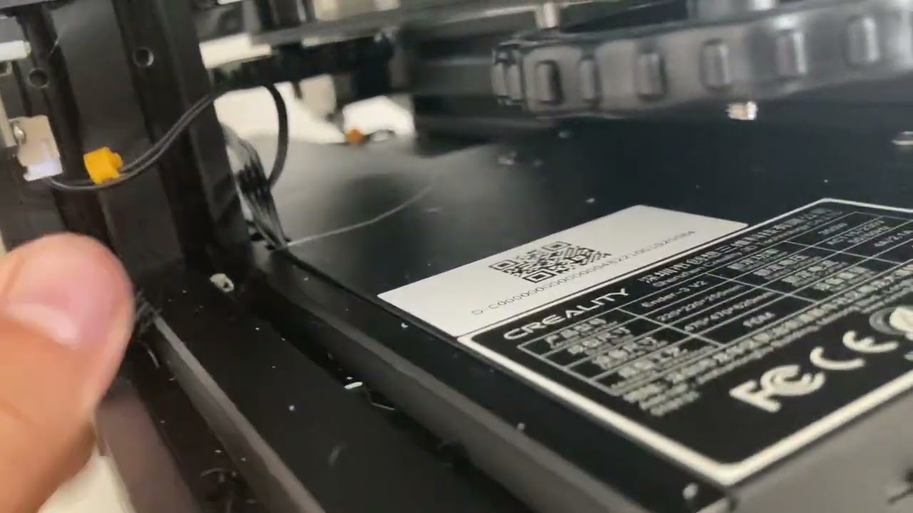

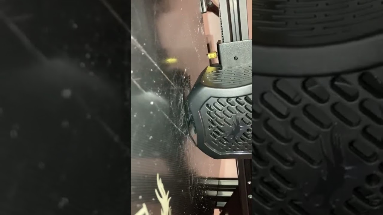

I have just brought a Ender 3 V2 3D Printer. Im using PLA filament
Nozzle Temp: 200, Bed Temperature: 60 Degrees.
The initial laying of the filament never sticks to the bed, screwing up the rest of the print.
I have tried to use Painter tape, and glue stick to improve the adhesion.
Attached is a short video of the printing, and the file I am using to print with.
I am using the ultimaker cura slicing software, since I am on a Macbook.
Attached is the file Im using to print with.

From the first video it looks like there is far too much room beteween the nozzle and bed. When setting it up it should be between 1 and 2 bits of paper, if you use Glue or Magigoo you can usually get away with a looser tolerance but is always good practice to keep it close.
Hi Jon, thanks for posting those videos. They show the issue quite clearly - it’s evident that there is too much clearance between the bed and the nozzle.
3D printers need to be calibrated to sub-millimeter accuracy to get reliable printing results - they are far from 2d printers that are just plug and play. Getting your bed perfectly levelled is tedious, but well worth the effort.
The piece of paper trick will get you a rough starting point from which you can tune your first layer height. 0.2mm (200µm) clearance is fairly standard - looking at your video there appears to be 1 - 2 mm of clearance, or 5 to 10 times what it should be.
