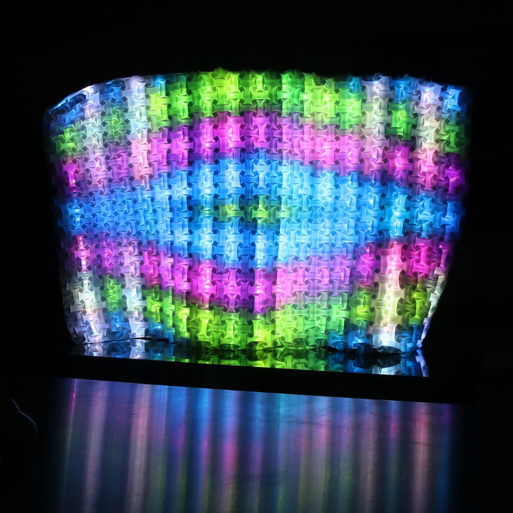

Brendan7266 just shared a new project: "Wefted Waveforms"
This project aims to fuse neopixel strips with papier mache and origami into a free-standing electro-sculpture.
The freestanding structure is formed from wire mesh and papier mache. It is then painted and wired up with strips of LEDs connected to an RPi3+Teensy+OctoWS2811 Adapter + Power Supply. The entire LED covered surface is then covered in a diffuser created from modular origami elements glued together. Finally, some VJ software (Glediator) is used to create realtime animated patterned displays.
