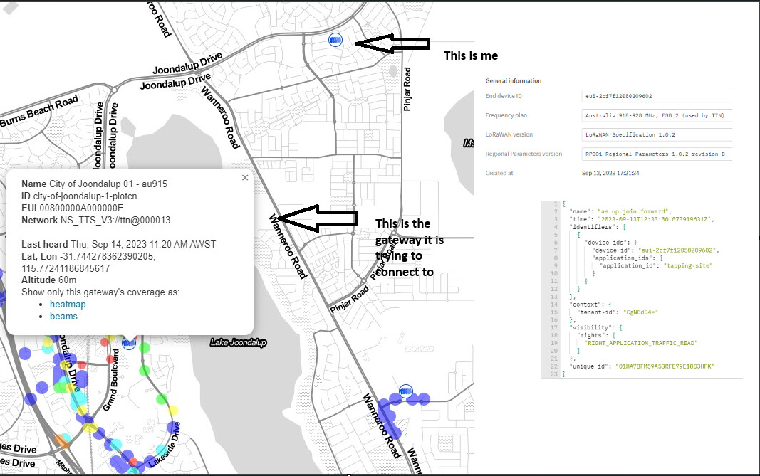

Do you have a gateway nearby? And do you know what settings it might be running?
Yes see map…

I may have been too quick to post. It turns out I had a typo in the DEVEUI and that is why it would not join, however it always posted the DR=0 when it failed to join. Once I fixed the DEVEUI, it joined no problem and the DR=1 was posted. I am not sure why there is a difference, maybe timing? I know timing is everything with LoRa.
