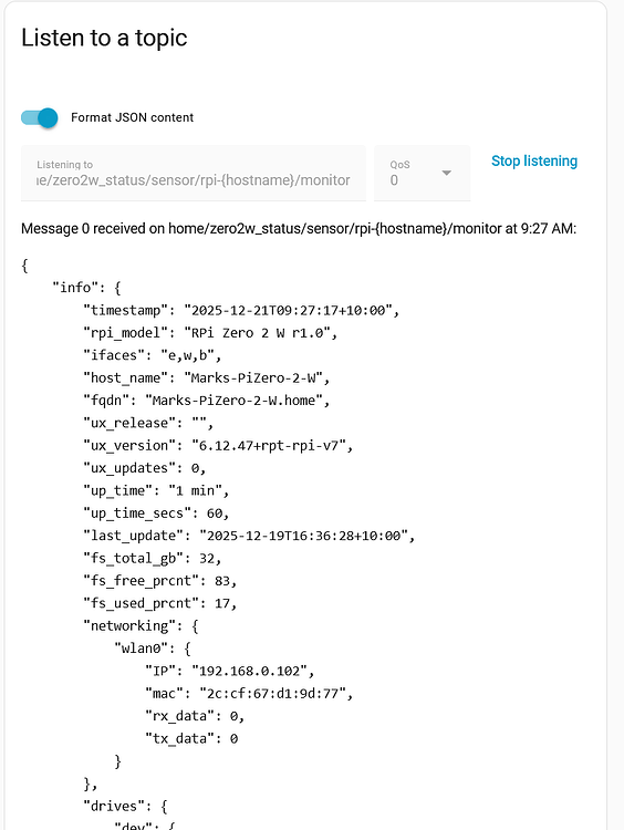

I have it running on a Zero 2 W which is publishing every 5 minutes.
I can see the data for this the topic ok in MQTT Explorer and Mosquito MQTT/Setting/Listen to a topic with no problem. See below.

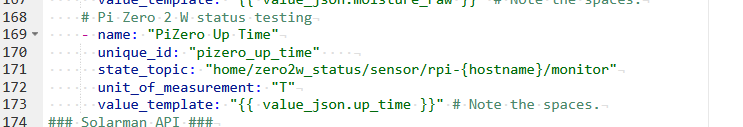

I added a sensor in configuration.yaml under mqtt:sensor: for “up_time” (see below) but can’t get HA/Developer tools/states to return a value.
I feel I have some basic error in the config file with the topic (or not…) but I can’t see it.

Out of curiosity, are you able to pull “up_time_secs” by any chance? I ask because it looks like “up_time” is formatted as a string whereas “up_time_secs” is formatted as an integer. I’m not sure if that would make a difference.
Thanks Jane but nothing on that either.
up_time_secs returns unknown.

As suspected the issue was me not understanding the sections with the json string.
Info section:
○ Up_time_secs = value_json.info.up_time_secs
○ Temperature_c = value_json.info.temperature_c
Networking section:
○ IP = value_json.info.networking.wlan0.IP
Drives section:
○ Size_gb = value_json.info.drives.root.size_gb
Memory section:
○ Free_mb = value_json.info.memory.free_mb | int where “| int” defines the value as an integer.
