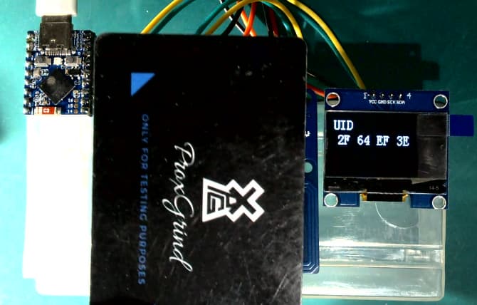

My test readers arrived, so a very quick hack up some c code (based off the published python code) and while it needs work, its working :slight_smile:
So I have an ESP32 S3 mini, the pico reader and added an 1.3" OLED for the fun of it.
the OLED is on one i2c port, and the reader is on the next i2c port.
Made a very quick video but cant upload video here… so a few photos.
Setup
RFID Field detector (if flashs as I dont leave the field on, I turn it on, check for a card and get its UID if there, then turns the field off)
Card 1 (Yes it should be a 7 byte ID (for the guru looking), but I am lazy atm so just 4 bytes)
Card 2 (from one of my kits)
So I think we can say the UID reading bit (for 4 byte UID) is working for a single reader.
The ESP32 is also connected to my home WiFi, so next part will be to test sending that to a server to process.
If there is anything specific you would like me to test, let me know and I will see what I can do.

Over the weekend I got the 7 byte uid working in my code as well as the mifare classic read/write from/to a block, so now have a firm grasp of what I believe can and cant happen on the logic side.
I setup a test UDP server on my PC and had it track what UID come from what reader and how many times. (I when UDP as there is no sessions to manager, and the data being send is small enough to fit into one MTU Sized packet.
I had two readers running off the ESP32 S3 mini with a simple round robin poll/check for card. This seemed more then faster enough (especially with just a UID).
I ordered some cables to test cascading up to 4 readers over some different length wires so see how stable it will be over longer leads.
