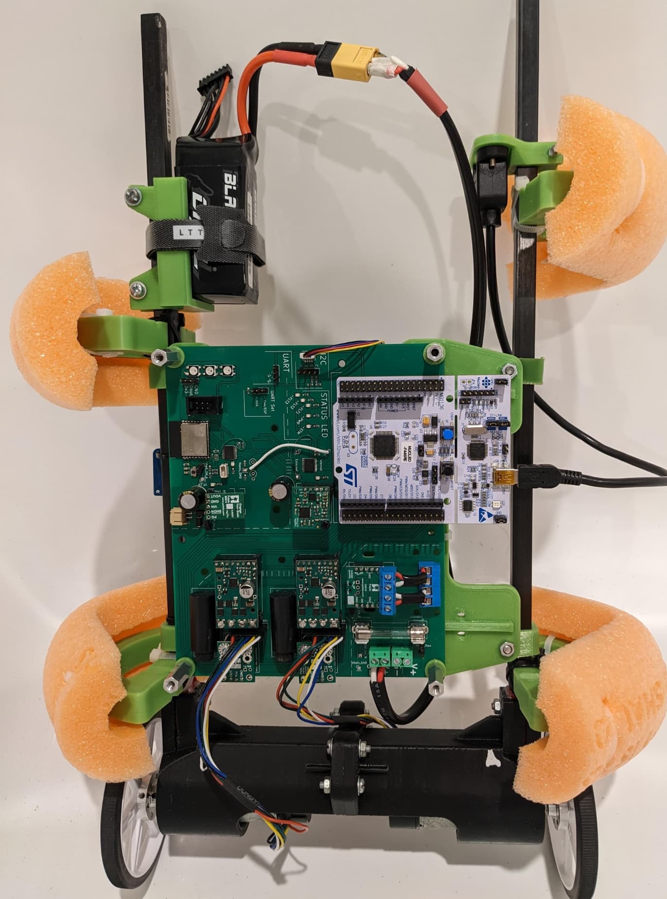

My class at uni made some balancing robots from the ground up using a more engineering approach rather than the Maker way of throwing a PID at the problem (and hand tuning).
Liam

Awesome uni project. Looks like your 3d printer got some good use.
