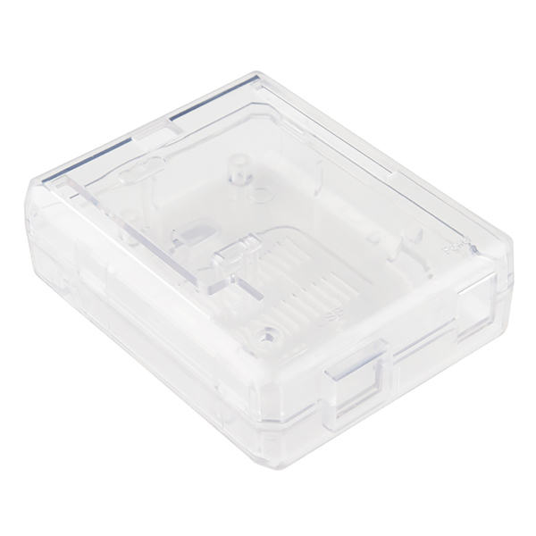

This is an example of an enclosure that you could use.
Thanks for the additional suggestion Jim.
I have gone for the red case as it is fully sealed and I can mount it on a panel easily, upon which I can also mount an emergency stop button and any other external switches I might need for my CNC build.
