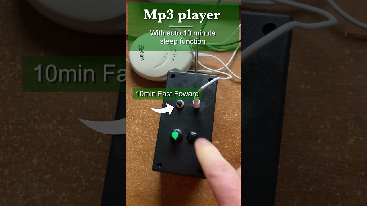

I made myself a podcast player that plays for 10 minutes and turns itself off for when I sleep. I used a nano clone with a DFPlayer. Here’s a very short video of it in action.
