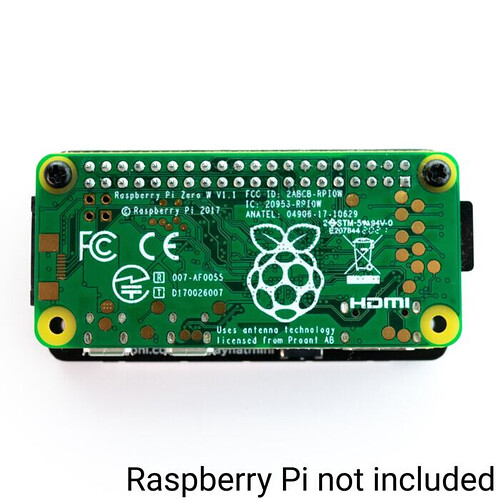

Probably your best option is the Display HAT Mini which comes with four buttons on a 320 by 240 pixel display. It’s still small, see image below of it on the back of the Zero for reference, but its probably the best option if you want the buttons as well.
