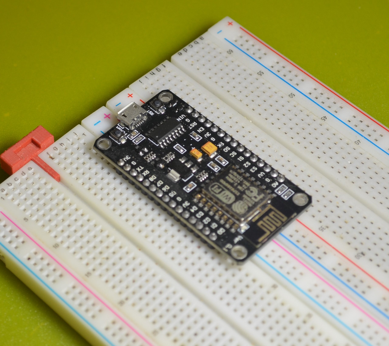

Hi @Alan37799
Ive been loving these mini modular bread boards that connect up.
You can see in the photos there are little notches on the side and matching receivers on the other side.
You can string together three like this and I bet the wroom32 will slot right in. I put in ruler for scale so you can measure it. ![]()
Pix ![]()
Thanks, Pixmusix.
I have a few of these already. Sadly, when joined they don’t provide electrical connectivity between the boards, so you just end up adding a heap of jumper wires to link each together.
Cheers!
The type that has power strip down the side works really well for the wider modules when they are doubled up.
The type with a power strip on each side is used for the widest modules (12-row), but if they are one row smaller you need the type with a power strip on one side only. Best of all are the ones where the power strip is a separate piece - that gives maximum flexibilty.

You already have got many options. You can also make a solderable breadboard. Here is a design of a solderable breadboard. It’s DIP-compatible PCB for prototyping. It fits Arduino Nano, ESP8266, and NodeMCU.
