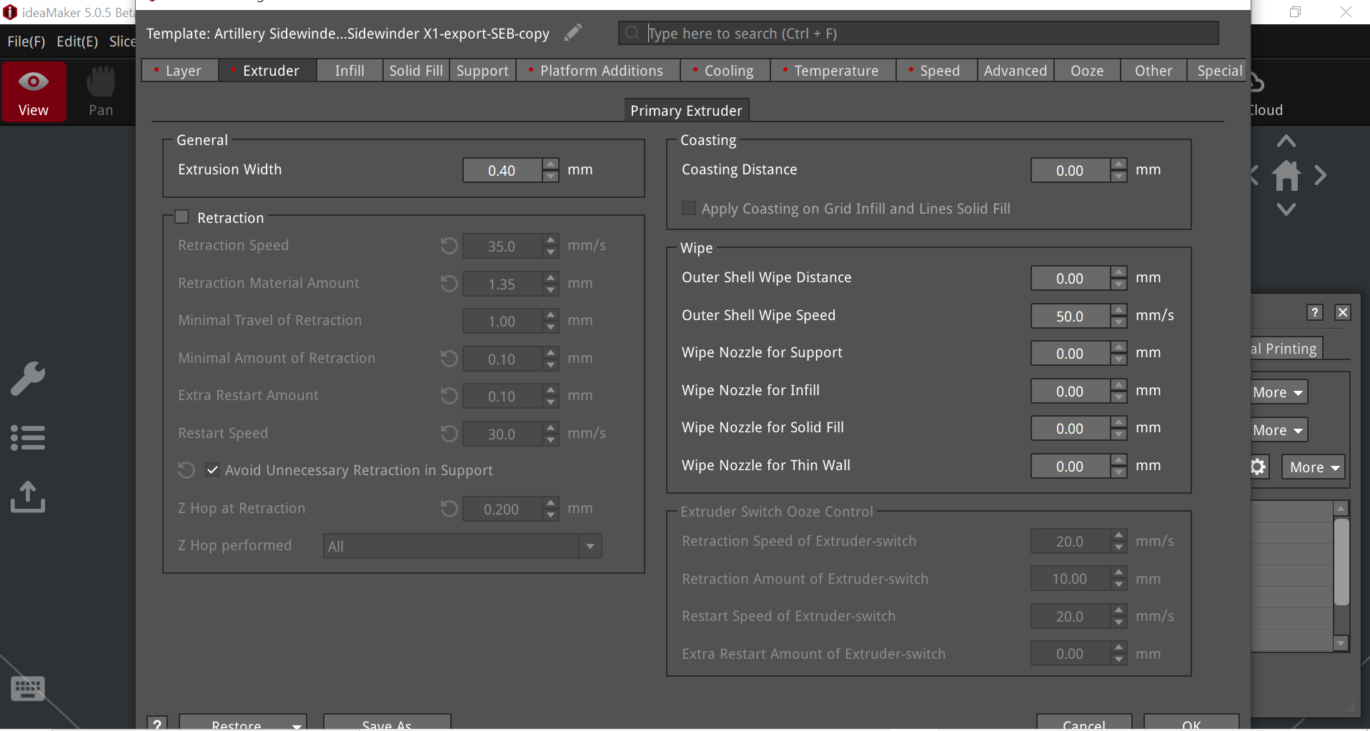

Hi I just upgraded from stock firmware to marlin 2.1.2.2 and this TFT firmware GitHub - pinguinpfleger/ASWX1-TFTFW-MOD: Artillery Sidewinder X1 TFT Firmware Mod I’ve also calibrated e - steps x y and z axis stepper motors and I’ve been tweaking some adjustments in ideamaker etc. but i am struggling from really bad tolerances and i don’t know hot to fix it, I’ve printed some tolerance tests and i didn’t even manage to get the 0.5mm tolerance for some reason. it also stops at the same spot partway through a print and just sits there and makes a big blob around the nozzle. ive attached a zip with my ideamaker profiles if it helps

That said though, 0.5 mm is definitely something wrong. I would start by rolling back all your changes and testing it bit by bit to see what’s at fault. My first bet would be a slicer issue so maybe roll back your slicer settings to defaults and give it a go. Stopping on the same spot everytime sounds like some slicer config issue.
If that doesn’t fix it, maybe give the old firmware a go and try to revert the machine back to “factory setttings” as much as possible. If software and firmware wise it’s at a point where it worked previously and it’s still not working then you know it’s a hardware fault.

Do you know what the “Default” slicer settings would be? i don’t really have an actual base slicer settings. also for a long time i have been experiencing really bad elephants foot, that may have something to do with it. i might print a Cali cube to see if the stepper motors and extruder are actually calibrated or if i possibly messed it up while calibrating it. ill keep you posted!

For the slicer settings easiest way to get the defaults would be to add a second machine exactly the same as your first. Alternatively you could look at using another slicer Cura/Prusaslicer/Orca to see if you get the same issue.
And when I think it may be a slicer issue, I think it may be how the slicer is set up for the printer, not the print settings. To eliminate any slicer settings try and install Cura, it has an inbuilt default setting for the x1. Just do a test print and slice it in Cura to eliminate any weird slicer issues.
