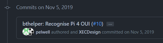

This is a known issue and they have a fix deployed, however it wasn’t added to the apt for some reason. This is for the 8GB model, however.
In brief, this is a known issue the Raspberry Pi devs are working on. The fix is out and it works but it just isn’t in the update system yet. If you need it working right now follow the instructions in RPi4 Bluetooth woes - Raspberry Pi Forums

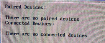

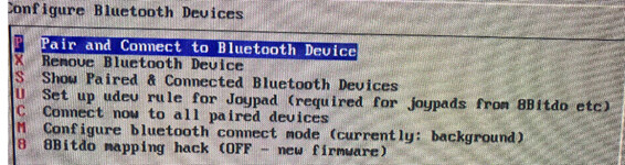

I purchased a Ultimate Retro Game Console With SN30 Pro+ controllers back in March and had a heap of problems with connecting the controllers up via Bluetooth. It was extremely frustrating and I just didn’t have the time to follow it up in the forum until now. I think I have the same issue that @Clayton149871 has noted above. I cannot connect either controller via Bluetooth - they only work wired.
If I start from no paired nor connected devices:
Paired to find a controller:
Chose the ‘DisplayYesNo’ security mode but then get the following error:
Same happens with other controller. Both still appear on list of paired devices:
However, when I press start, they don’t actually connect. The lights just keep flashing on them. ‘Connect now to all paired devices’ also does nothing. Confirming I have bluetooth connect mode set to background and 8Bitdo mapping hack set to OFF. I have also set up udev rules for each controller in case this is relevant.

I have tried connecting the controller using the different modes (i.e. depending on what button you hold down with Start). I have noticed that the name of the device sometimes differs between then (e.g. “Pro Controller” vs “8BitDo SN30 Pro+”) but no joy in any mode that I could find.
