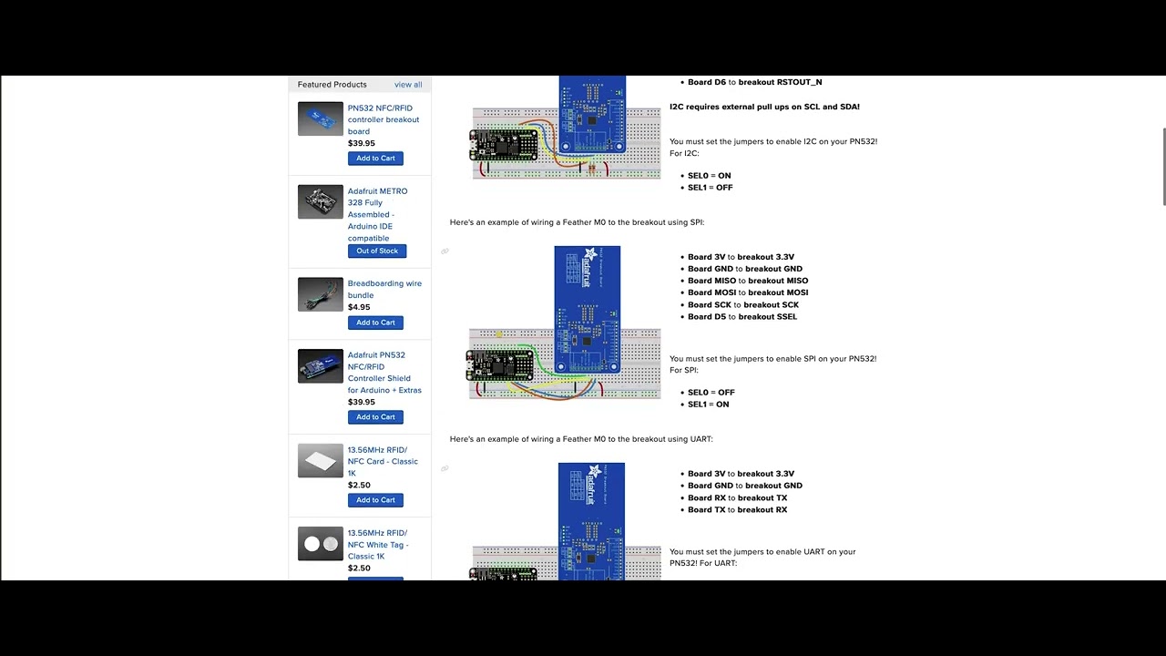

My process is often to make CE staff recommend a product that they trust in their inventory. Then I search model number of that product to see how other people use it.
I recorded and example of me searching for RFDI module examples below. Found some good looking example code in what… a minute?
Notice that I found a small section of sample code on the manufactures website. I then copied and search from that line of code to find other people that used the same code. That lead me straight to an entire example.
Hopefully that gives you some idea.
