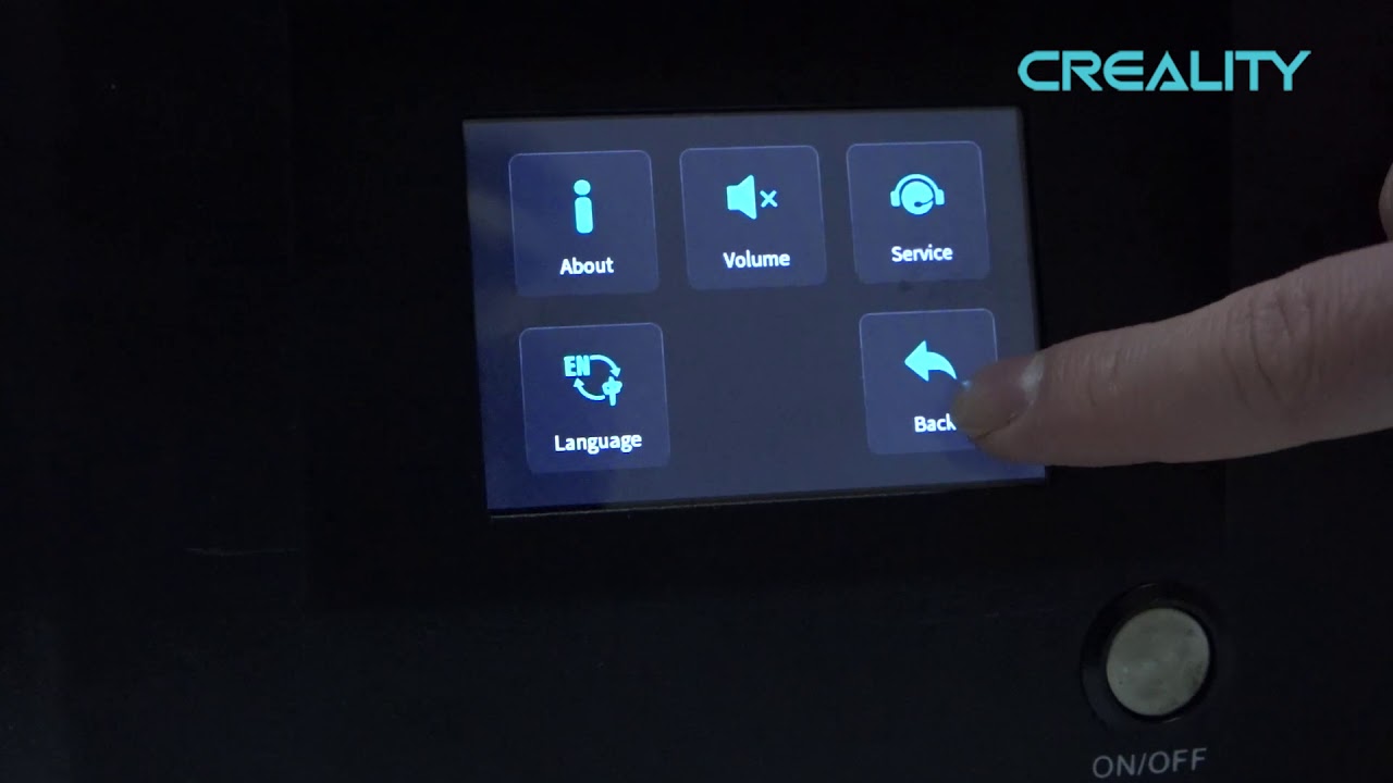

What I understand from other sauces is to be able to get ChituBox v1.9 to work one has to update the firmware, now that could be a problem, any ideas on that one. If you are selling these machine I would think you should have this info.
I haven’t had to update my firmware yet, but it seems it comes with a bootloader already, so all you really have to do is copy some files onto the USB drive that you use for printing, start up the printer, and have it do its thing:
