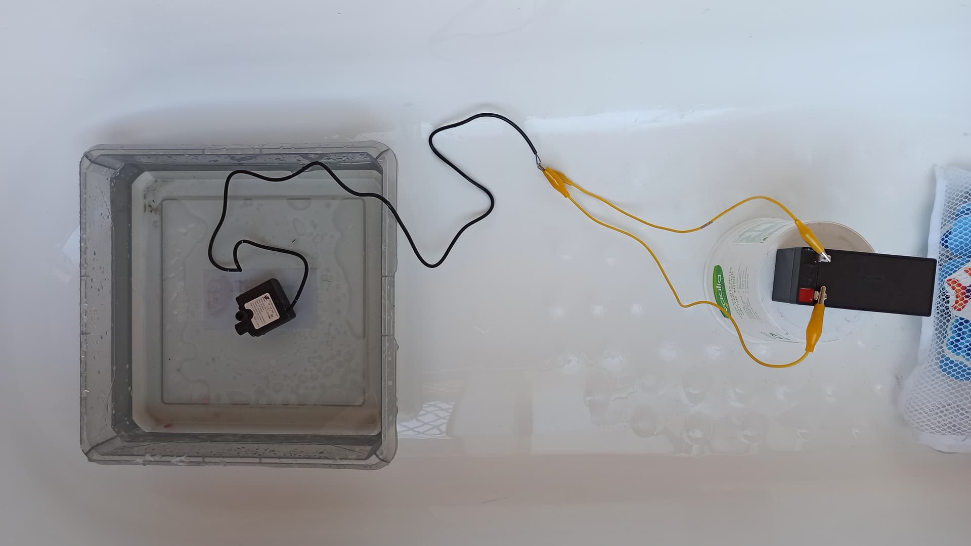

Have purchased this pump and having issues with it. Have tried 6V, 9V, 12V and 18V batteries and can’t get it to function. Have only tested it in water as per instructions no luck. Am I doing something wrong?

It’s unlikely you’re doing anything wrong - in the sense that you would risk damaging the pump or doing something unsafe. Sending through a photo would be the fastest way to get info.
What kind of battery setup were you using? If you have some AA batteries in series they might not be able to pull enough current through to power them - PS: the pumping head is proportional to how much power you are sending to it. Higher the voltage - higher the curent => more power
Not AA in a series. Had a little spurt when I first tested then nothing.
Hi Nick,
If that SLA battery is >10V that should work.
Do you have a multimeter to test anything with? I’d check the batteries open circuit voltage and then using the 10A setting test the current going through the motor.
If you have some spade connectors handy it might be worth crimping them on to try that. From the sounds of it its in connection between battery and the motor from my intuition.
Hi Liam
Yes the connections don’t look that crash hot do they.
I would say pretty ordinary.
Your suggestion of spade connectors crimped PROPERLY has a lot of merit and should be expedited.
Cheers Bob
Hi Bob
If the wire makes direct contact with the battery I don’t see why it wouldn’t work. A spade connector won’t improve that will it?
Yes it will certainly improve the type of connection depicted in the photo. It would seem to only just be making contact and as soon as any current is requested the contact would pretty much disappear.
