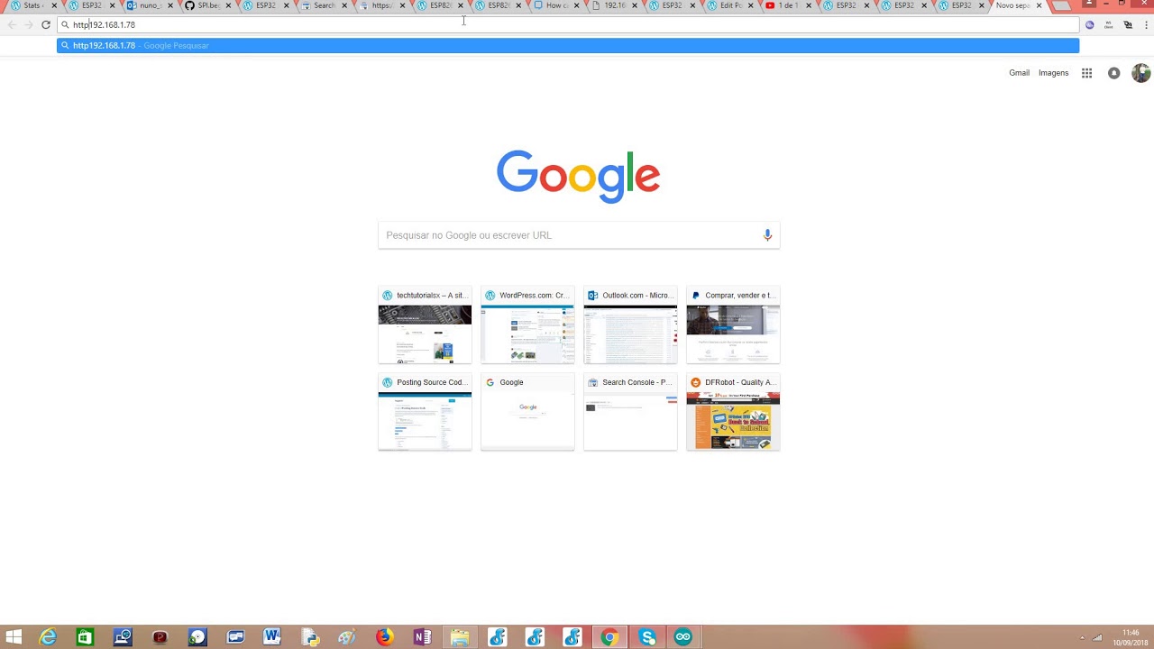

Hi Liam,
I’ve been doing some research (others call it: watching YouTube videos!) and I’ve come across this one:
I was wondering if it was along the lines of what I am trying to achieve?
I can’t tell if it is and I’m a little concerned about mucking around with the code which works perfectly (on one device).
I will be trying to have the two motors working on two different devices at the same time, or remove the code for one motor altogether and just have one ESP32 controlling one motor via one device.
Thanks…
Hi Gianni,
It looks like it is something along those lines.
You can always make a copy of the code and try stuff yourself!
I’d go for it, the world is your oyster!
