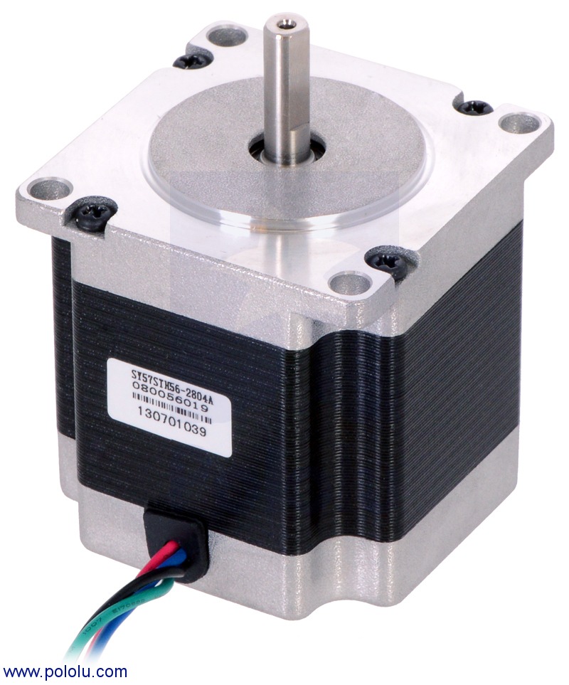

This is the closest I could find to that stepper motor:
The current limit is a little lower, but if you’re worried about torque we have a slightly larger NEMA 23 motor you could substitute that would be OK for your driver (4A is huge)
