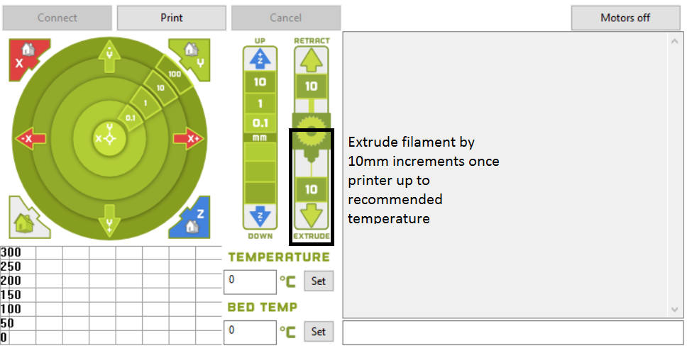

Are you able to consistently extrude any PLA (when your hot end is around 190 degrees) using the Cura Printer Control Interface Extrude Function?
This is great to know. If you have material extruding via the manual controls then the hotend is purged and ready to use.
During the start sequence, the filament will retract a couple of centimeters, and if you simply hit stop and reprint, it will retract again. The outcome is “no material” on your first layer while the hotend pushes out air from those earlier retraction events.
If you change filament, abort a print, reattempt a failed print, or simply unsure if your printer is “ready to print”, then you should always purge the hotend as above. This ensures material is ready-to-print, and no hassles on that first layer.
