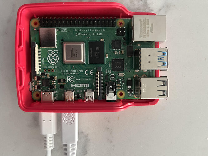

Would you be able to upload a picture of the device and how everything is wired together? The Raspberry Pi 4B actually has two mini-HDMI ports and some users have stated that only only the port closest to the Power Supply has audio.

Hi Jane,
Please find photo of device and external hookups
Regards, Craig Newton

Hey @Craig303545,
What device are you trying to play audio through? Some HDMI monitors don’t correctly advertise their audio capability, so the Pi doesn’t enable it. A quick test is to plug into a TV or another HDMI display, if you get sound there, your original display likely has an EDID compatibility issue.
