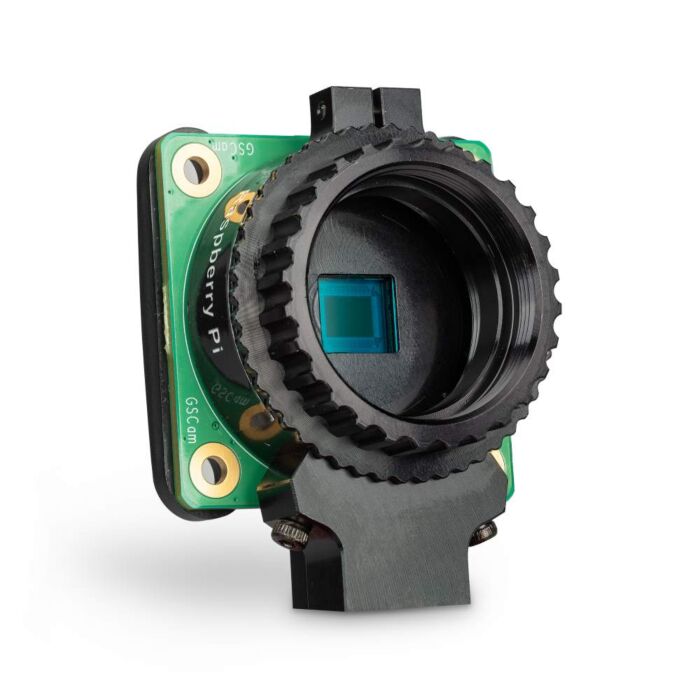

I thought of doing something like this but wasn’t sure if the filter goes over the lens, as pictured, or if it was to be placed on the actual sensor.
The High Def camera
has the filter on top of the actual sensor.
As you have suggested, placing the filter like this seems a bit flimsy, but if that is all that is required, and it works, then so be it!
