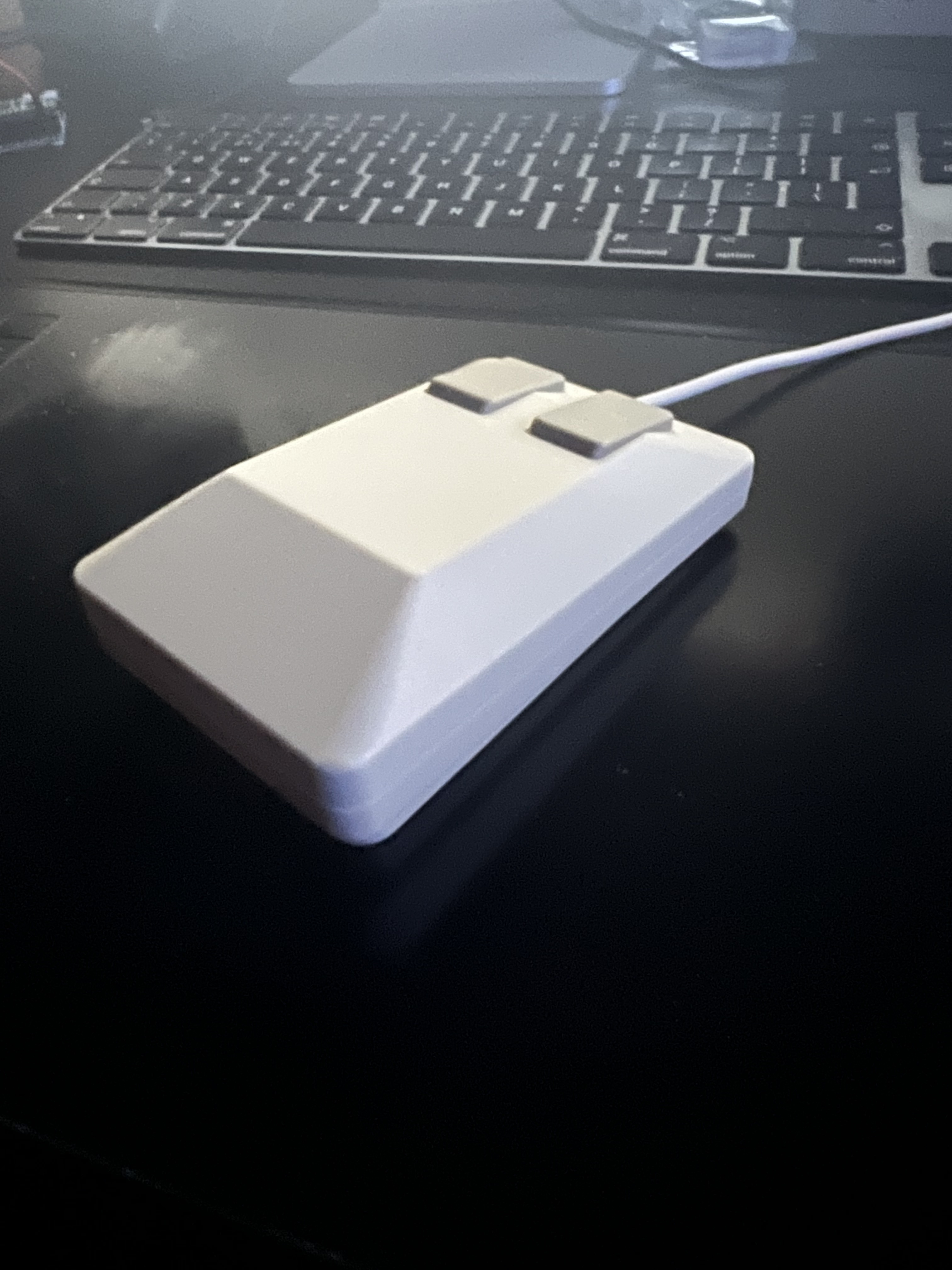

SUCCESS! :smiley:
Solved by this bad boy here! (Came with the A500 mini)
Anyone remember these :slight_smile:
Brings back good memories of a similar adventure many years ago…
So yes, it seems any Logitec mouse I had did not like the Pi. This works PERFECTLY.
Sorry to run you around.
Really appreciate your patience and help, Ryan!
Scott
