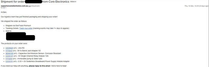

I seem to have the same/similar problem. In my case, neither the mouse nor keyboard are working anymore after I updated the OS (on the recently purchased official SD Card from Core Electronics), as per Raspberry’s official website recommendation: “we no longer recommend or support using NOOBS” - https://www.raspberrypi.com/software/ . And just to advise, I purchased the (attached) components from Core Electronics within the last fortnight
