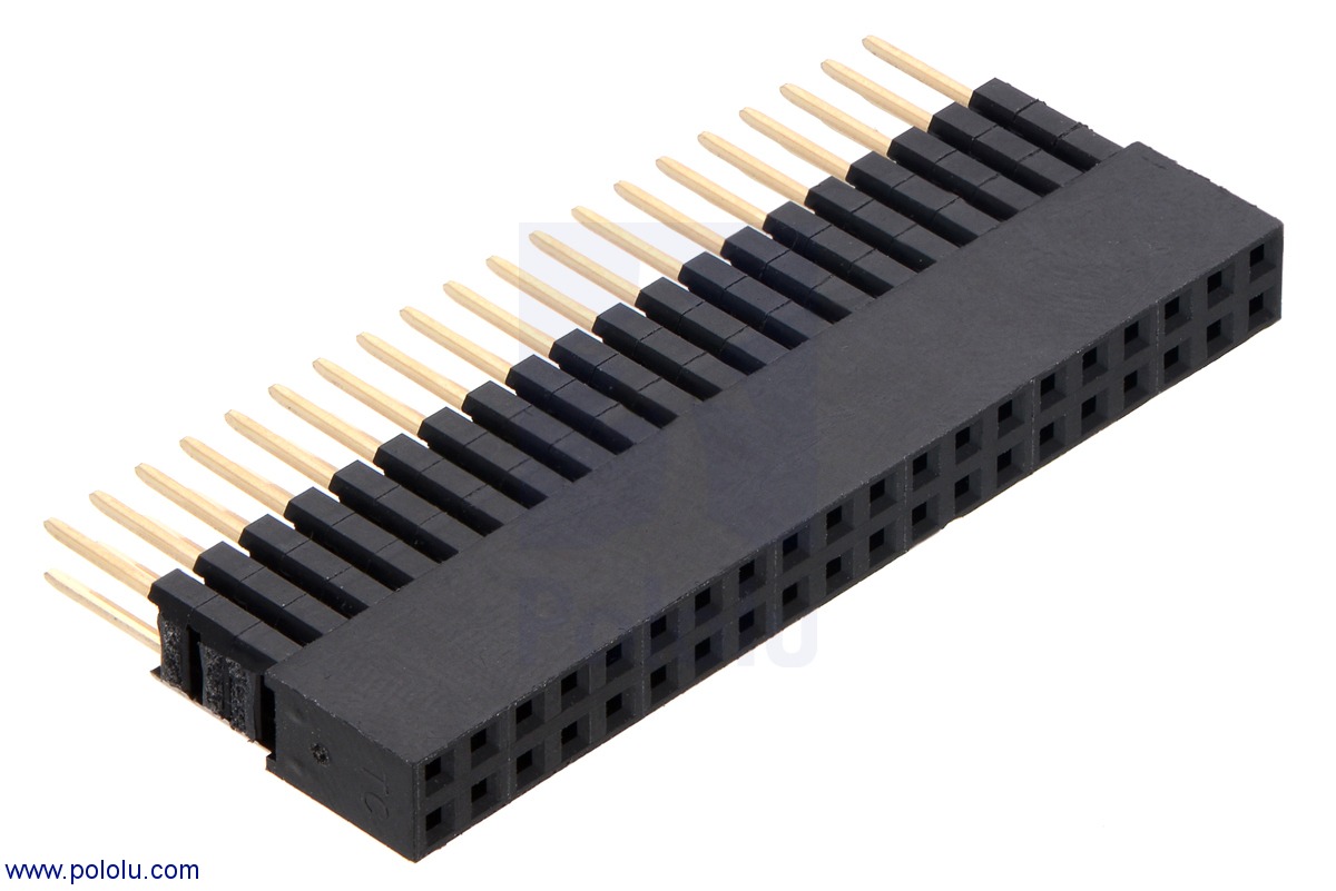

Some spacers (I suggest using nylon) would be a good idea for airflow as you’ve said, there are some stackable header pins that should make that much easier to incorporate such as these ones:
