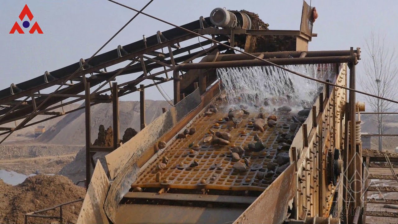

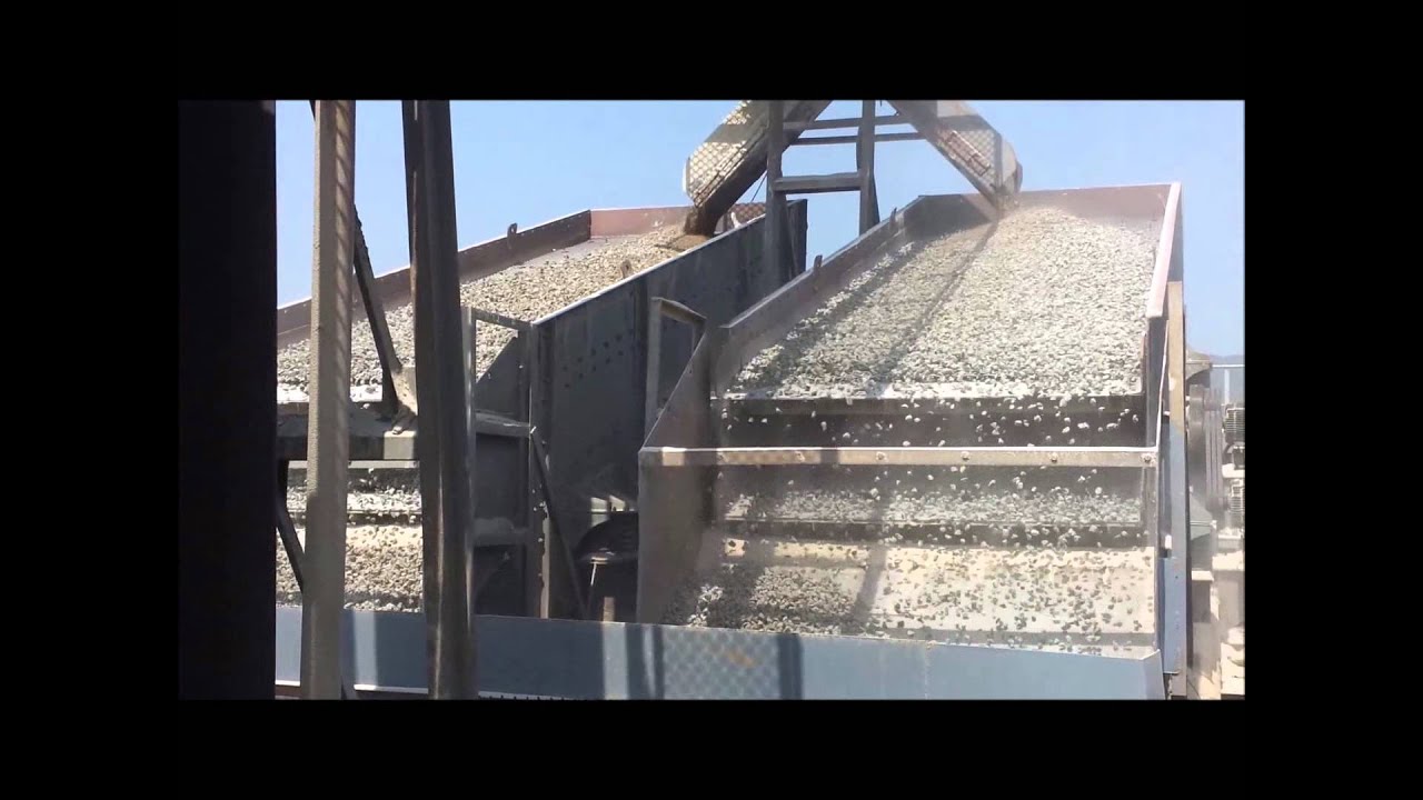

In industrial applications vibration motors (also knows as eccentric mass motors or exciters) are used to drive vibration feeders and sorters/screens - these things could literally shake your entire house apart.

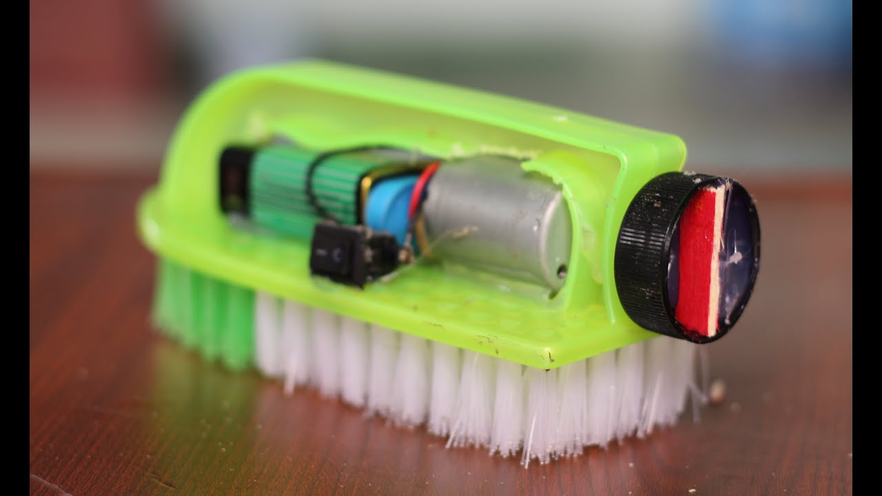

Though you can turn just abut any motor into a vibration motor by mounting an eccentric mass on the shaft (common approach for making brush bots), for example:

Thank you Oliver, that BristleBot looks amazing
