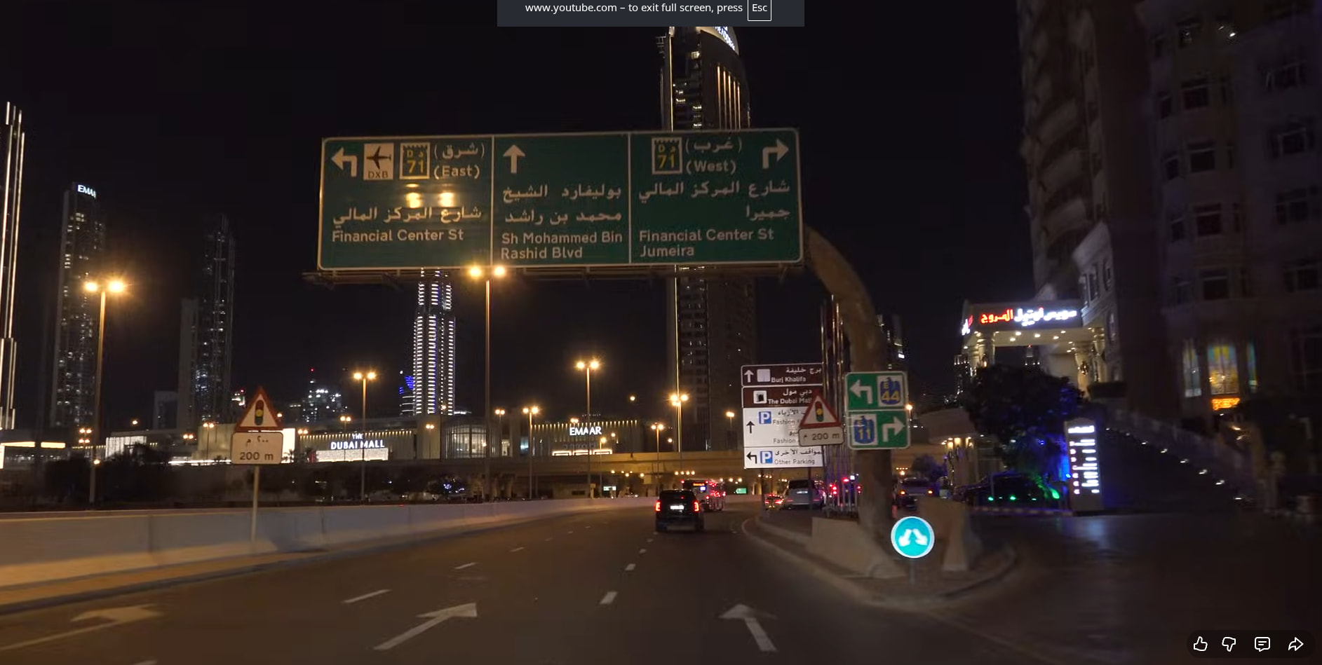

Night use case should be able to look as clear and bright as this example image:

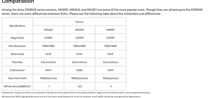

What an interesting deep dive I just took - g-sensitivity apparently is one of the driving factors for this.
Here is a comparison of a similar product using the same sensor:
This sensor uses the same as shown in the photos above: https://core-electronics.com.au/arducam-2mp-ultra-low-light-starvis-imx462-motorized-ir-cut-camera.html
There is some blurring, but for the price thats pretty phenominal!

Hi guys thanks for the suggestions, I think I will stick with imx378 but can you advise would it look similar to this image:
in terms of clarity?

How was this image captured? With a generic digital camera? Embedded cameras usually do not give images as clear as digital cameras.

I don’t know this was from a youtube video I took a screenshot and shared it on this forum.
