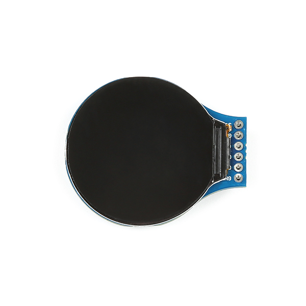

In terms of hardware I’d definitely head for something that can interface with a microcontroller - I’d check out the Round LCD from Pimoroni (I’ll preface this with I haven’t used this display in any projects): 1.3" SPI Colour Round LCD (240x240) Breakout | Pimoroni PIM570 | Core Electronics Australia
They have some alright looking examples for the Pico: pimoroni-pico/micropython/modules/picographics at main · pimoroni/pimoroni-pico · GitHub

Sounds like a cool project, just to add a few more hardware options into the mix. Sparkfun has just launched two round displays that have a micro-controller build into the back of them.
Called the RoundyPi and RoundyFi respectively.
Having the built in wifi connectivity of the RoundyFi is almost certainly overkill for a beer tap though.
