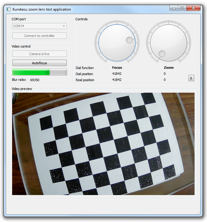

I did find this interesting project for it though:
