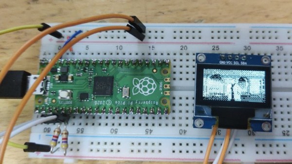

From what I can find just using a USB to TTL serial cable may give you some issues as the I2C communication protocol doesn’t play nice over USB directly. Usually people get around this by using a microcontroller to translate.
I Found this example using a Raspberry Pi Pico interesting:
Hope this helps!

Thanks for the reply. The Elecrow User Manual doesn’t list specifically which pins. I can see that the hat doesn’t utilise pins 27 to 40. The Pico idea is interesting.
