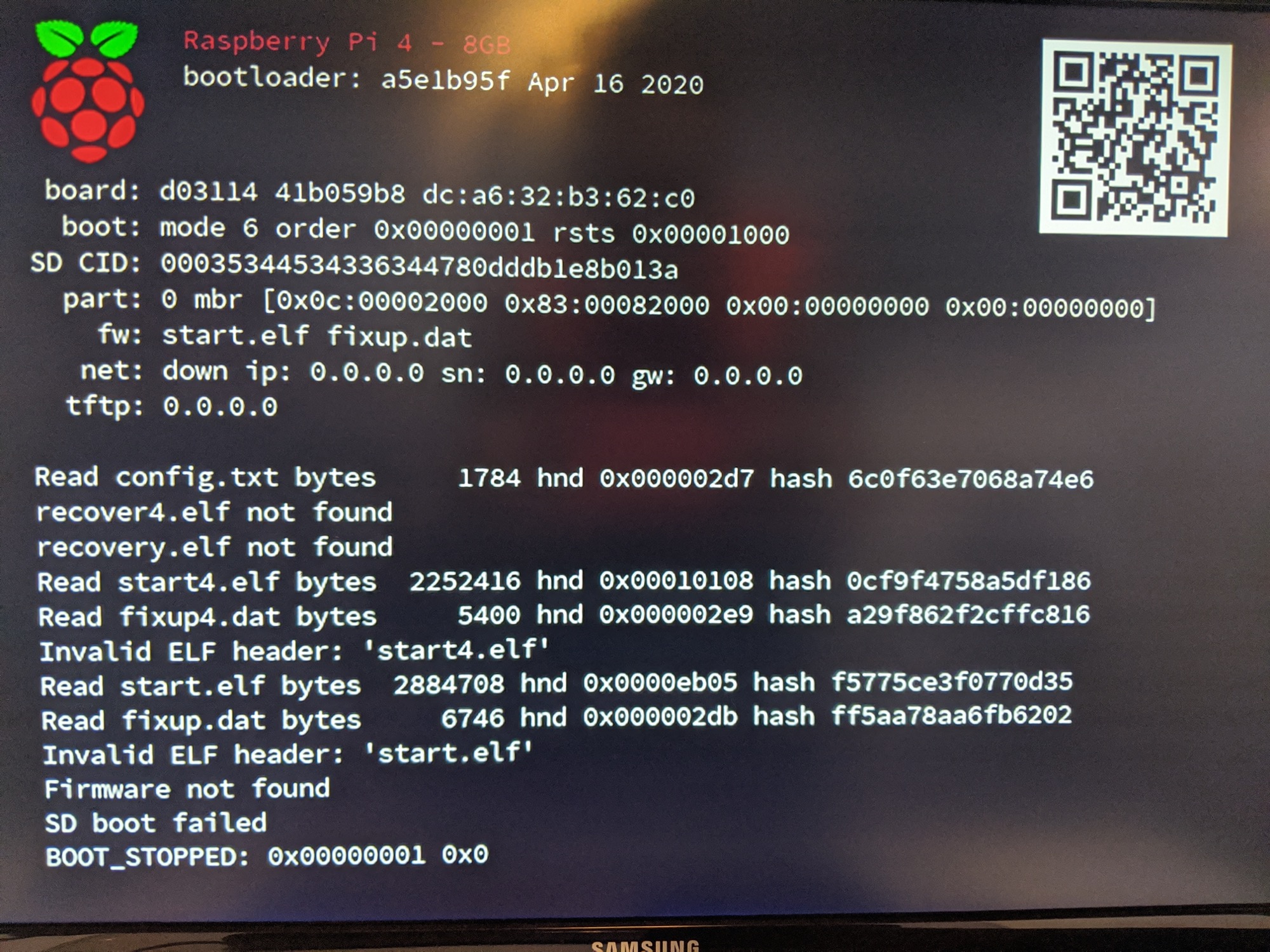

I recently bought a Raspberry Pi 4 (8Gb model), and am having problems booting into any operating system. I’m using the official RPI power supply, and the HDMI cabling works with another RPi4.
I had prepared a Micro SD card with Ubuntu 18.04 (64bit). See screenshot, it stops booting saying the board requires newer software.

I was able to resolve the problem by reformatting the SD card and installing Raspberry Pi OS (32-bit) Lite. This allowed me to boot into the OS and do updates and upgrades.

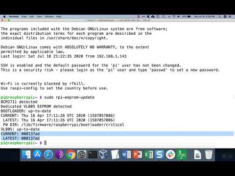

  • If Pi 4 - Check that the Pi4 bootloader is correct with the recovery steps.

my boot loader boasts sep 9 2020…so it just could be out of date or has become unstable…
i agree with Bryce on this issue…need to reinstall the boot loader…
you casn write into the loader file before you flash it i have re-flashed mine using ubuntu i changed the boot order so it boots fron the usb port if it cannot find a op-sys on the usb it then looks at the sd-card
