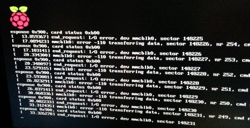

There are guides to turn your distro into a read-only boot media. This means they will be less likely to suffer damage from a sudden loss of power.
